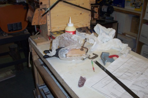

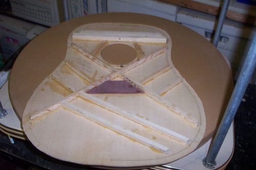

Here is what i've been up to lately, i made and glued the end and neck block, repaired some cracks on my sides with HHG, built a go bar deck a la Pat Foster(thanks bud), made my own kerfed linings and glued half of them tonight. I also glued my rough braces onto the underside of the top with HHG which was my first trial and i had way too much squeeze out, if someone knows how to clean up dried HHG, pleas let me know, it's rather embarrassing! My bridge patch is a piece of purple heart!

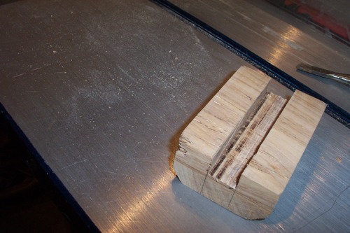

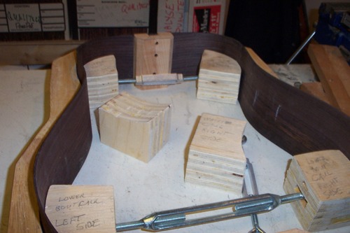

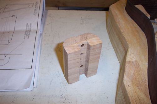

End and neck blocks

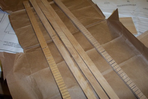

Here's a shot of the first set of linings i had made out of black ash but had to discard because of weight issues

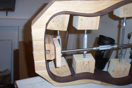

Some more of the neck block

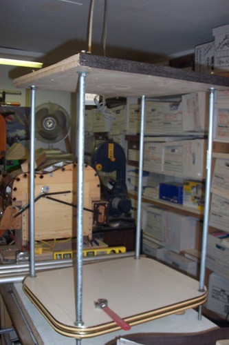

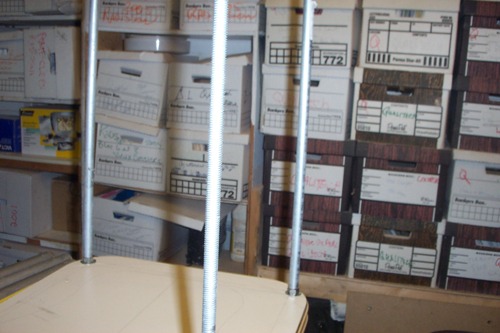

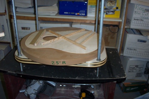

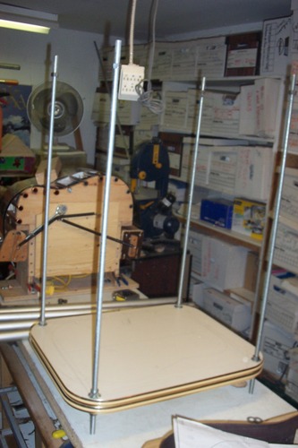

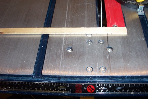

The go bar deck construction and the mess from sawing them go bar rods and braces

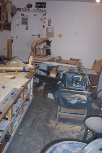

What a mess, try to beat that!

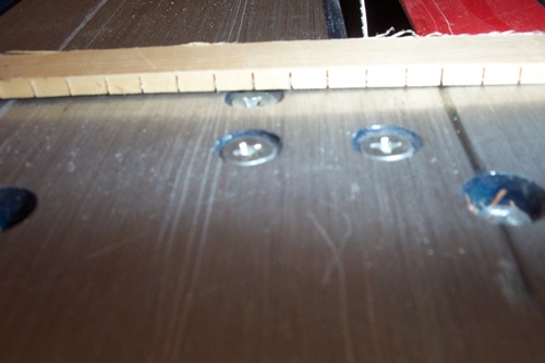

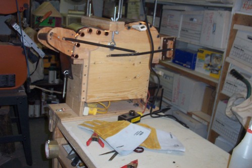

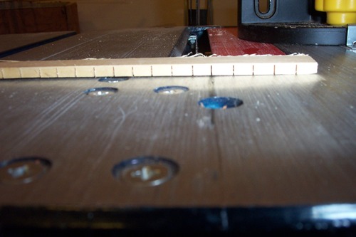

Here is how i made my kerfed lining as per some advice from Mario.
The kerfed strips are a cookin'! Loves ma bender!
My messy braces

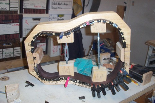

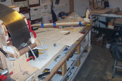

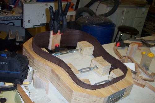

The glueing of the kerfed strips, i just had enough clips and clamps to do them on one side, gotta buy me some more one of these days!

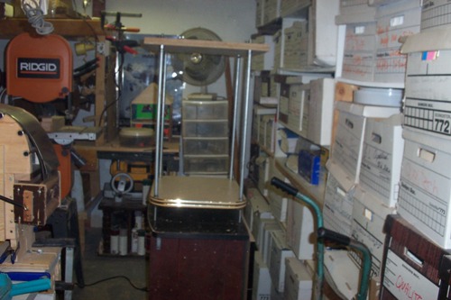

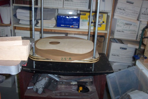

Dave, the go bar deck was easy to make, the top is 2 layers of 1/2" GLUED MDF, the bottom plates were salvaged from some old living room furniture, it has 4-1/2" threaded rods and just oversized tubing to help lock it all tight! i'm thinking of securing it on top of that purple rolling table with shelves to make it easier to move around.

PostPosted: Mon May 08, 2006 12:03 am
   Hola budy! That's looking great! The easiest way to clean up HHG is about 15-20 minutes after you've clamped it up. It's like jello at that point and you just need to scrape it off with a knife/chisel/piece of wood... You can remove it without a trace. Now that it's dried up, just us a clean rag and boiling water... Damped the rag (just a little bit) and keep it on the glue. It should loosen up quickly enough. Do just a little spot at a time. Keep a hair drier handy. Once you've taken away the excess glue, dry up the spot immediately with the drier (this step is important) ... Or you can heat up the dried glue with the drier and rub with the damp rag. Either way will work.

Alain, great tip bud, i'll know better next time, Thanks!

Lookin' good there, Serge. And your deck actually looks a lot stronger than mine!

Compliments on the Go-Bar deck, Bud! That should keep the Bears' shop a "Boing Free Zone"!
Is that 5/8"(15.7mm)or 1/2"(12.6mm) thread stock? Can't tell from here.
Hey! Where's the beer drink'in alien poster?

Billy, the thread stock is 1/2" inside the tubing as per Pat Foster's go bar deck photo he showed in his tutorial and my beer drinking alien was drinking behind my back! Thanks dude!
